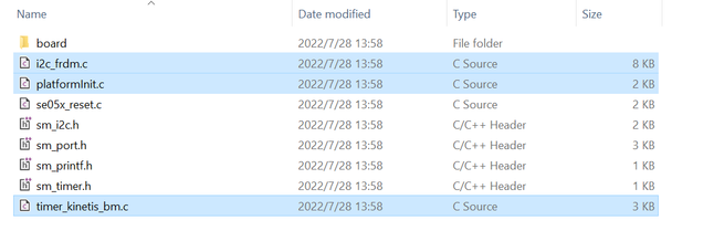

Kan_Li
Hi @chirag123 ,
Basically the following source files in the platform folder need to be updated with your custom MCU SDK drivers, and you may compare the files between different platform folders for more details.
Kan
