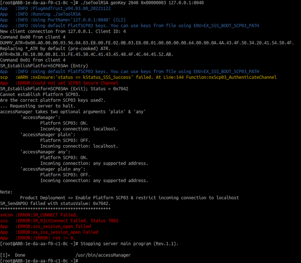

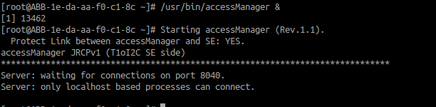

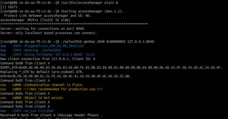

I did 3 tests:
1 - access manager and applications with SCP/auth: NOK.
But if I understood correctly, this is not needed because the access manager will be handle with the authentication/SCP.
2 - access manager with SCP/auth and applications auth=none: NOK.
3 - access manager with SCP/auth, but started without scp enabled and applications auth=none: OK.
How can I enabled the SCP/Auth properly?

Hi Cristiane,
attached a plain and SCP03 communication screen shot as well text files containing the I2C bytes in text from (captured with the help of a logic analyzer). It shows that the communication between the SE and the host is encrypted in case of using Platform SCP for the access manager.
In case ABB would like also to protect the communication to the access manger they would need to use an authenticated session.
In this case only two sessions are supported by the Secure Element! This may not be sufficient for ABB's use case.
