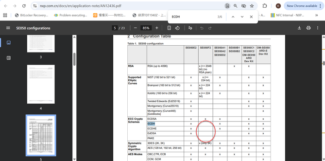

I am sorry, but this feature is not supported on SE050F2. Please kindly refer to the following for details.
Please refer to https://www.nxp.com.cn/docs/en/application-note/AN12436.pdf for more details.

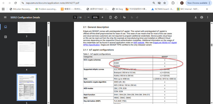

If you need a FIPS certified SE05x with ECDH support, please use SE052F instead.
Please refer to https://www.nxp.com.cn/docs/en/application-note/AN14277.pdf for more details.

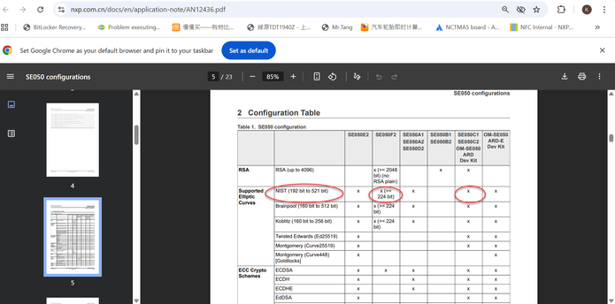

Yes, both SE050C1 and SE050F2 support generating an ECC key using the NIST-P384 curve. Please kindly refer to the following for details.
