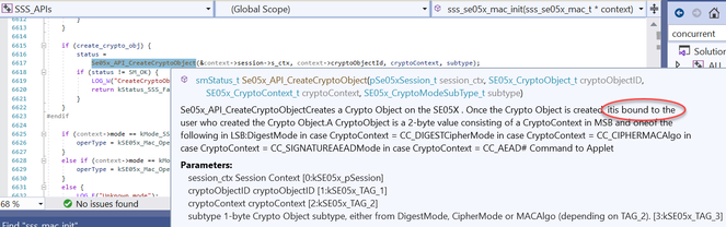

Kan_Li
Hi @bug_squasher_77 ,
Thanks for the information! I am digging into the source code and suspecting maybe your issue happened there as shown below:
so most likely your code tried to update some secure object created by another user and failed to do that due to the policy.
Please kindly check from your side if the object ID is duplicated .
Hope that helps,
Kan
