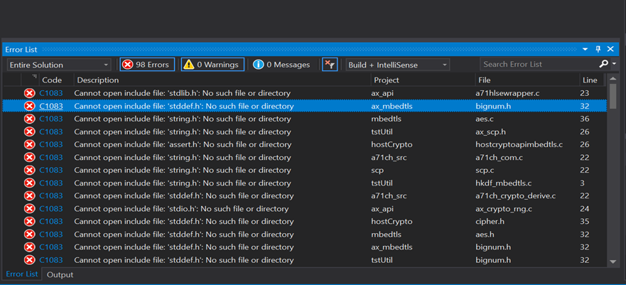

Unable to build using A71CH Configure tool as mentioned in the 7.2 section of the AN12135 document https://www.nxp.com/docs/en/application-note/AN12135.pdf getting the following errors in visual studio.

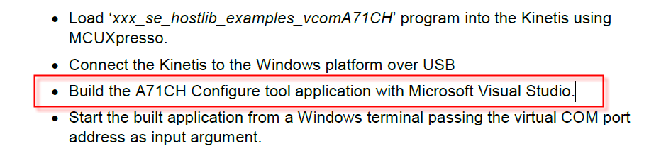

Kan_Li
Did you meet you in the following step?
Would you specify the visual studio version as well as the host sw package? I will try to test it here.

pavankumar_vadh
Yes, in that step only. It's Visual Studio community 2017 version 15.9.7. How to know the host SW package?

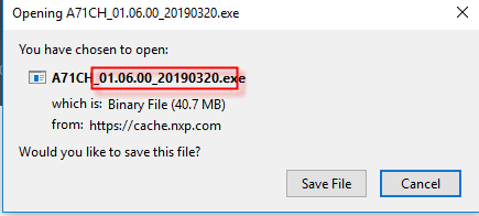

Kan_Li
The host sw package is downloaded like below:
The info in red is the Sw version .
Kan

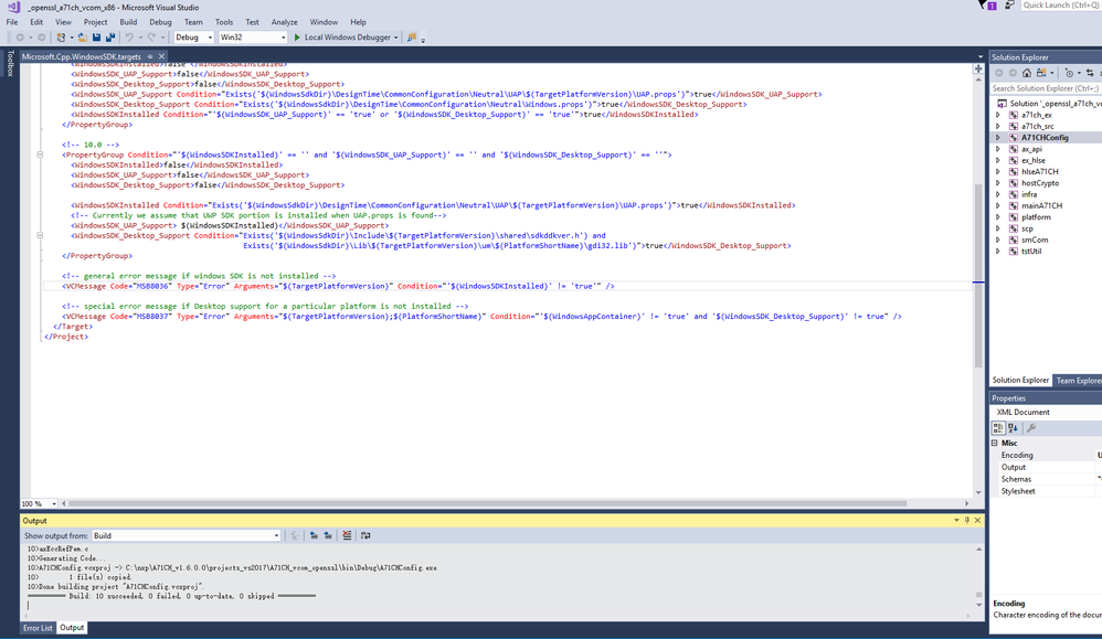

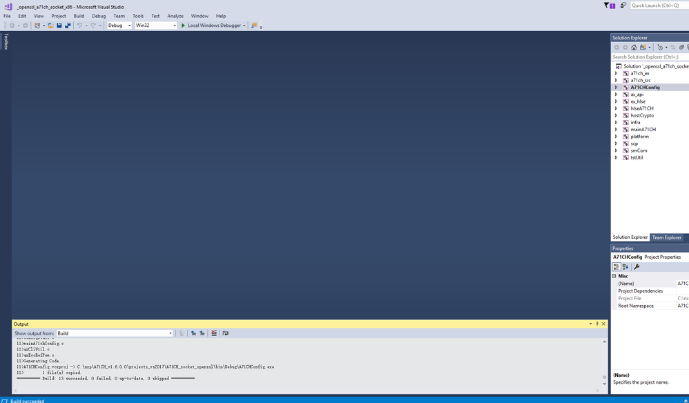

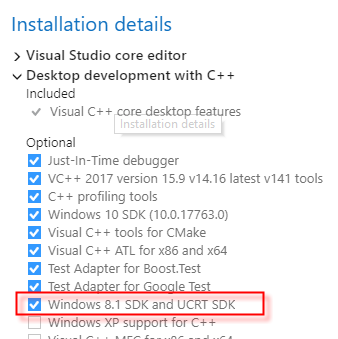

Kan_Li
I built both of them, with some error showed "Windows SDK 8.1" needed, and after installation, they are built successfully.
Hope that helps,
Kan
