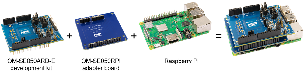

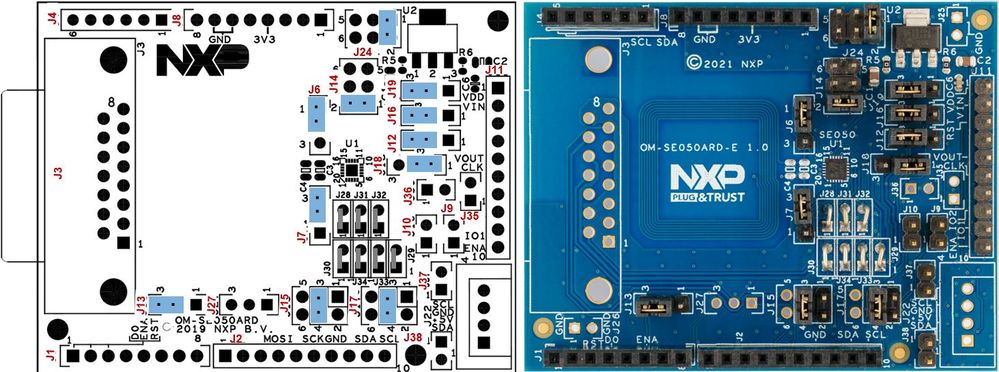

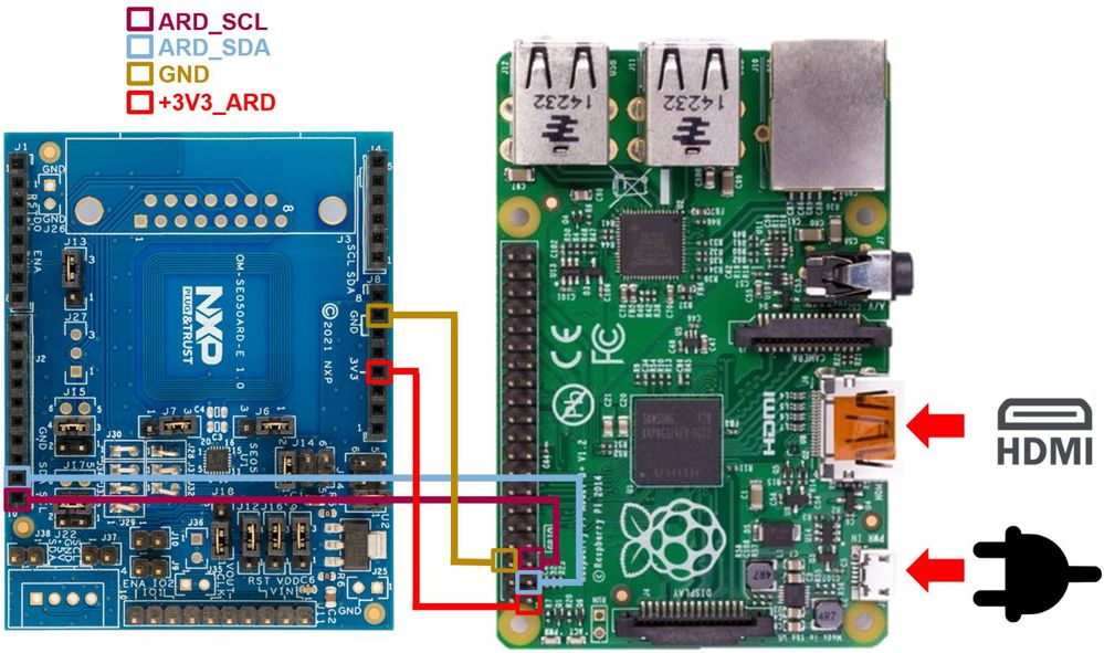

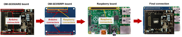

Connecting the OM-SE050ARD-E to the Raspberry Pi
Make sure the jumpers in your OM-SE050ARD-E board are configured as shown in the figure below (equal to the default configuration of OM-SE050ARD-E
Stack the OM-SE050ARD-E with the adapter board to the Raspberry Pi
Alternative it is possible to connect the OM-SE050ARD-E via wires to the OM-SE050RPI Raspberry Pi board as shown in the figure below:

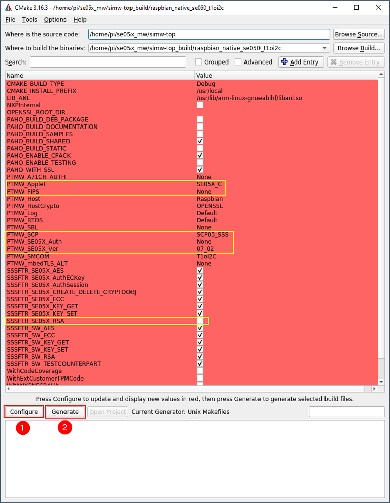

Run the following commands to build OpenSSL engine for SE050. For further details see please “AN12570 Quick start guide with Raspberry Pi” chapter “4.1 Example: SE050E CMake build settings”. If the hostname is “raspberrypi” automatically the config for a Raspberry Pi is created:
cd simw-top
python3 scripts/create_cmake_projects.py
cd ~/se05x_mw/simw-top_build/raspbian_native_se050_t1oi2c
cmake-gui .
Update the CMake settings as shown in the figure below. Press first the Configure button and
second the Generate button and close the CMake GUI.

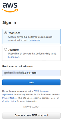

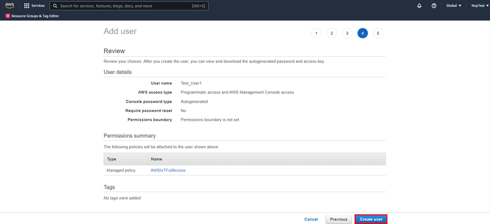

When you first create an AWS account, you begin with a single sign-in identity that has complete access to all AWS services and resources in the account. This identity is called the AWS account root user. Amazon strongly recommend that you do not use the root user for your everyday tasks, even the administrative ones. Instead, it is recommended to create an IMA user. Please read the following documentation for more details: What is IAM? - AWS Identity and Access Management (amazon.com)

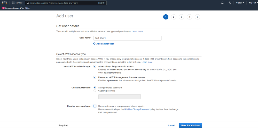

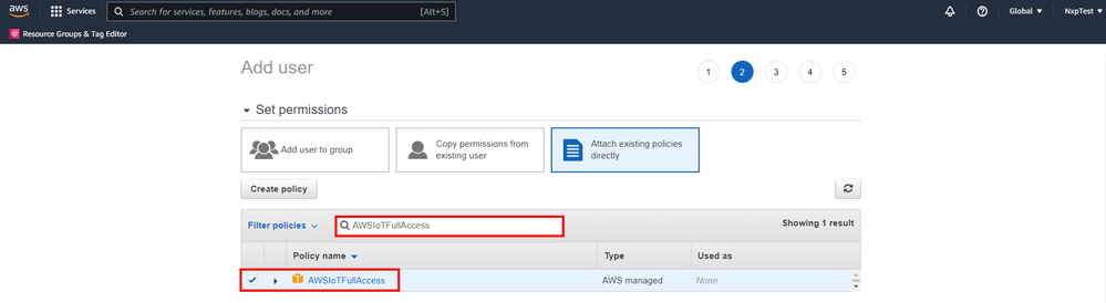

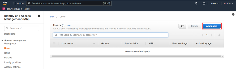

Perform the following steps to create an IAM (Identity and Access Management) user.
  1. Sign in as AWS account root user by using the email address and password that you used to create the AWS account.
  2. On the navigation menu, choose “Users” and press the “Add user” button.

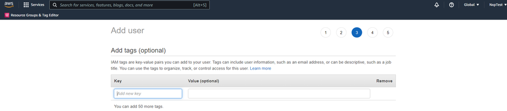

  3. Add a username and select the options as shown below and press the “Next: Permissions” button.

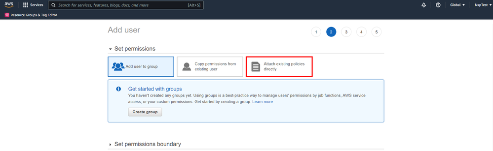

  4. Press the “Attach existing policies directly” button.
  5. For this demo select “AWSIoTFullAccess” policy and press the “Next” button.
  6. For this demo you do not need to add any tag. Simple press the “Next” button.

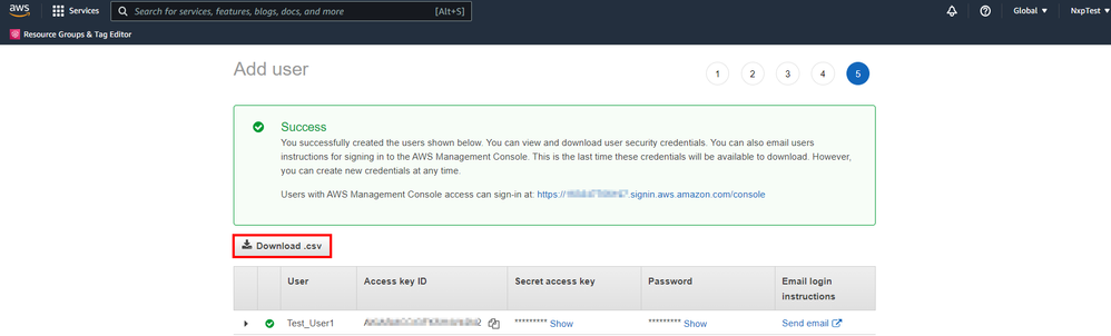

  7. Review your entries and press the “Create user” button.
  8. Finally download the IAM user credentials as csv file. For the next steps you need to retrieve the Access key ID and Secret access key from the csv file. The csv file includes the user name, the password, access key id, the secret access key and the console login link.
    You can use the console login link to login as IAM user.

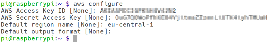

Set AWS credentials in AWS cli
You can save your frequently used configuration settings and credentials in files that are maintained by the AWS CLI.
Run the following command to quickly set your credentials, region, and output format:
aws configure
Example:
$ aws configure
AWS Access Key ID [None]: <access key ID>
AWS Secret Access Key [None]: <secret access key>
Default region name [None]: <aws region name>
Default output format [None]: json

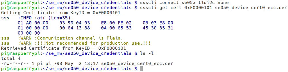

Extracting the EdgeLock SE050E Device Certificate
Using pySSSCLI Tool, read out the device certificate.
ssscli connect se05x t1oi2c none
ssscli get cert 0xF0000101 se050_device_cert0_ecc.cer
Extracting the EdgeLock SE050 Device Certificate.pngExtracting the EdgeLock SE050 Device Certificate.png

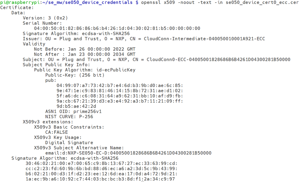

The Certificate/Public Key as read from the Secure Element can be inserted into the OpenSSL key structure. The x509 OpenSSL command also supports to display the public keys contents:
openssl x509 -noout -text -in se050_device_cert0_ecc.cer

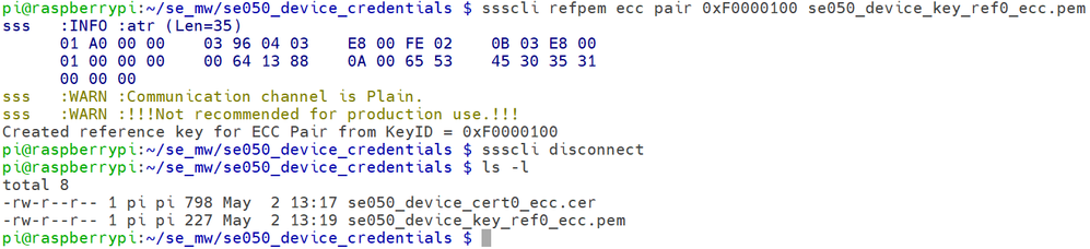

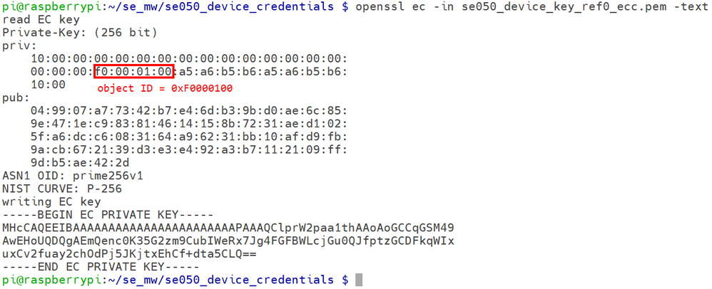

Creating the EdgeLock SE050E Device Key Reference
OpenSSL requires a key pair, consisting of a private and a public key, to be generated or loaded into the EdgeLock SE050E before the cryptographic operations can be executed.
Private Key: The Private key is securely stored inside the SE050E Secure Element and cannot be retrieved by the OpenSSL engine.
Reference Key: Standard OpenSSL API needs to be called with a key. Instead of a real private key the OpenSSL key data structure gets used with a reference to the private key inside the SE050E Secure Element. The reference key looks for OpenSSL like a real key, but it does not contain secret data.
Using pySSSCLI Tool, read out the device reference key.
sudo ssscli refpem ecc pair 0xF0000100 se050_device_key_ref0_ecc.pem
ssscli disconnect
Creating the EdgeLock SE050 Device Key Reference.pngCreating the EdgeLock SE050 Device Key Reference.png
In the first glance, the reference key looks like as any other private key, therefore it is
required to use OpenSSL to display the details:
openssl ec -in se050_device_key_ref0_ecc.pem -text

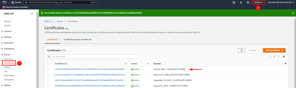

Registering Device Certificate
Use the AWS CLI Tool to register the extracted device certificate on to your AWS IoT Console.
The command line options are:
aws iot register-certificate-without-ca --certificate-pem <certificate-filename>
Execute the following command:
aws iot register-certificate-without-ca --certificate-pem file://se050_device_cert0_ecc.cer --status ACTIVE
This command returns the certificate ANR and ANR ID. A certificate Amazon Resource Name (ARN) uniquely identifies this certificate. You can open the AWS IoT console to check if the certificate was successfully registered.
Note: You need to select the correct AWS region.

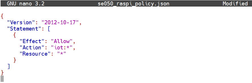

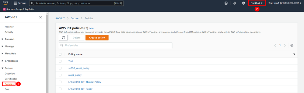

Create an AWS IoT policy.
First, create a JSON document “se050_raspi_policy.json” with the following content.
Note: this policy allows for demo purpose access to all IoT actions on all resources.
  "Version": "2012-10-17",
  "Statement": [
      "Effect": "Allow",
      "Action": "iot:*",
      "Resource": "*"
using for example the nano editor. The following command creates an empty file.
nano se050_raspi_policy.json
Copy & Paste the content into the text editor and save the file.

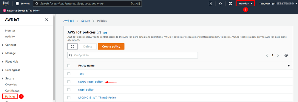

Use the AWS CLI Tool to create the policy on your AWS IoT Console.
aws iot create-policy --policy-name se050_raspi_policy --policy-document file://se050_raspi_policy.json
You can open the AWS IoT console to check if the policy was successfully created.

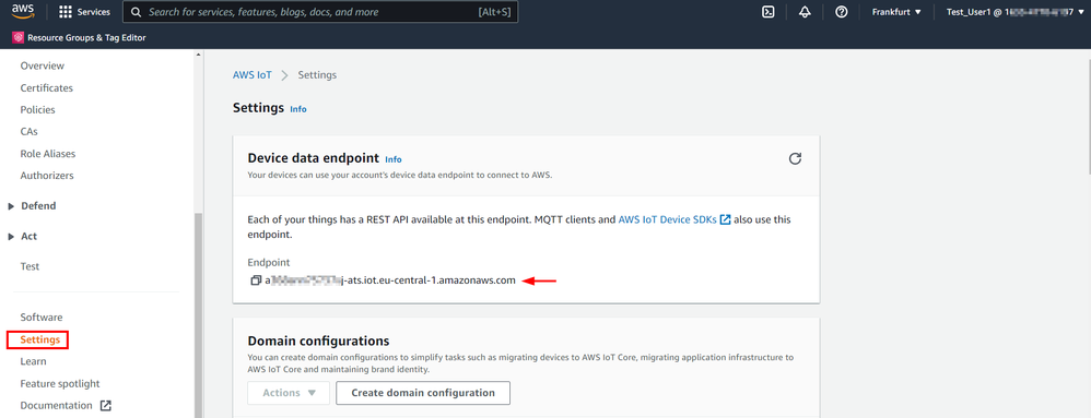

Obtain the custom AWS IoT endpoint URL
Run the following command to print out your AWS’ user’s endpoint address. This will be used later:
aws iot describe-endpoint --endpoint-type iot:Data-ATS
Obtain the custom AWS IoT endpoint URL.pngObtain the custom AWS IoT endpoint URL.png
Alternative you can obtain the customer AWS IoT endpoint using the AWS IoT console.
Obtain the custom AWS IoT endpoint URL_2.pngObtain the custom AWS IoT endpoint URL_2.png

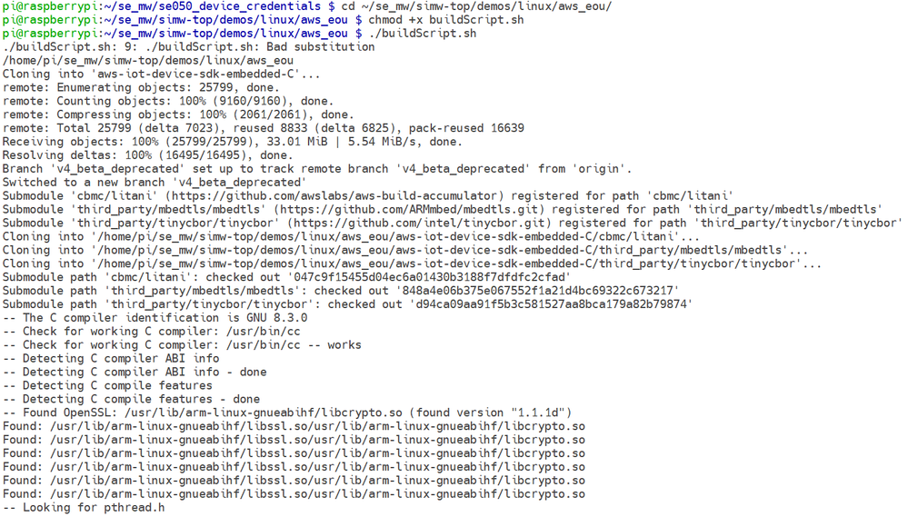

Run the IoT demo MQTT Example
Navigate to demos se_mw/simw-top/demos/linux/aws_eou directory and execute the buildScript.sh. This will build the project iot_demo_mqtt.
cd ~/se_mw/simw-top/demos/linux/aws_eou/
chmod +x buildScript.sh
./buildScript.sh

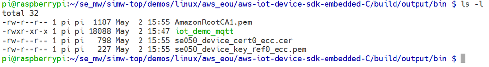

Copy all SE50 credentials into the example output/bin folder:
cd ~/se05x_mw/simw-top/demos/linux/aws_eou/aws-iot-device-sdk-embedded-C/build/output/bin
cp ~/se05x_mw/simw-top/demos/linux/aws_eou/AmazonRootCA1.pem ~/se_mw/simw-top/demos/linux/aws_eou/aws-iot-device-sdk-embedded-C/build/output/bin
cp ~/se05x_mw/se050_device_credentials/se050_device_cert0_ecc.cer ~/se_mw/simw-top/demos/linux/aws_eou/aws-iot-device-sdk-embedded-C/build/output/bin
cp ~/se05x_mw/se050_device_credentials/se050_device_key_ref0_ecc.pem ~/se_mw/simw-top/demos/linux/aws_eou/aws-iot-device-sdk-embedded-C/build/output/bin
To let openSSL use the engine set the openssl config path to point to the preconfigured config file:
export OPENSSL_CONF=/home/pi/se05x_mw/simw-top/demos/linux/common/openssl11_sss_se050.cnf

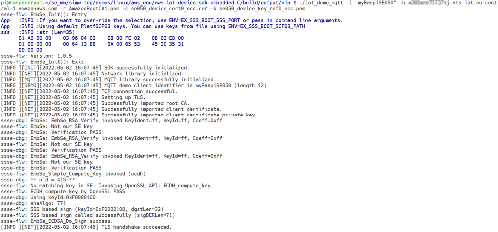

Run the demo with specifying your endpoint URL and certificate + key files:
./iot_demo_mqtt -i "ThingName" -h <endpoint> -r AmazonRootCA1.pem -c <certificate-filename> -k <ref-filename>
For example:
./iot_demo_mqtt -i "myRaspiSE050" -h <endpoint> -r AmazonRootCA1.pem -c se050_device_cert0_ecc.cer -k se050_device_key_ref0_ecc.pem

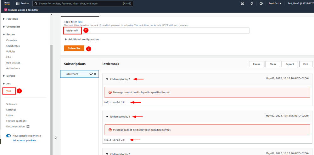

Go to the AWS IoT Core dashboard and subscribe to the following topic:
iotdemo/#
The MQTT topic you subscribed will now appear in the Subscriptions section as
shown in the figure below in case your run the demo again.
