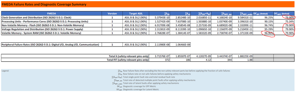

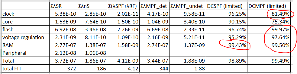

Dear Sir,
In the "FMEDA report part 2" of S32K116, I found that the DC_SPF and DC_MPF are with "limited" marker, detailed as below. But the actual calculated performance is much better. So, why you use a limited value?
567 Views
aarul
This is done to reflect that the device is meeting safety integrity requirements of ASIL-B and not ASIL-C/D.
