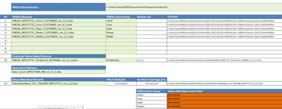

I am working on a custom DFMEA for the MPC5777C. I am trying to create a customer version of the summary (FMEDA_MPC5777C_Summary_INTERNAL_rev_1_0.xlsm). I am getting the following errors.

Hi Dave,
You are getting this error because the full path in FMEDA files aren't matching with path where these file are locally available in laptop. I would request you to please check the location of file path exactly matches with FMEDA files. If error still persist then may be we can have call or you can share the FMEDA files.
I hope this helps.
