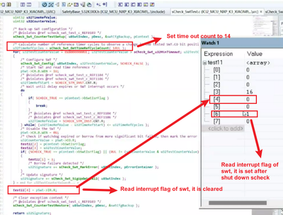

Junjie
Hi @JonasStyskala
We check with customer that the STM0 selected for scheck and 40MHZ as below
Let's add more details about this case.
1. when keep 10(actually 17 count ) swt count wait time out, scheck test pass ,but customer reconfigure swt after shutdown scheck test, swt work in abnormal. actually in this swt count wait time out, Test should not pass when set TO to 0x10.right? so why we set this count to 10?
2. when modify swt count wait time out to 14(actually 21 count )scheck test pass ,customer reconfigure swt after shutdown scheck test, swt work in normal , but interrupt flag of swt  was cleared in the end of test but set after shut down scheck,
3. when modify swt count wait time out to 17(actually 24 count )scheck test fail,customer reconfigure swt after shutdown scheck test, swt work in normal , interrupt flag of swt  was set in the end of test and also set after shut down scheck。
so there are 3 questions from customer:
1. when set swt count wait time out to 10. why reconfigure swt after shutdown scheck test, swt work in abnormal?
2. when set swt count wait time out to 14, why interrupt flag of swt was set after swt disable?
3. why we set wait time out to 10 in scheck swt?

JonasStyskala
Hello @Junjie, here are answers for customer:
  1. This needs to be clarified with HW team. I am working on that.
  2. This configuration is probably caused by race condition between SWT counter and STM counter. The test disables SWT right at the time of interrupt flag getting set, but SWT to CPU ISR reporting is not finished in this time.
  3. SWT timeout of 10 SWT cycles is set as longest timeout value which should not cause ISR to trigger. It is also sufficient timeout (with buffer) in which counter of SWT should change its counter value.
