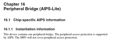

It seems that we cannot protect the GPIO controller using MPU: p.281 of S32K-RM.pdf rev 13.

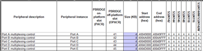

We know that the mux of the GPIOs can be protected, S32K1xx_Memory_Map.xlsx:
However the S32K148 doesn’t seem to allow to configure the access rights of the GPIO controller.
The aliased peripheral does not have any registers allowing privilege control.

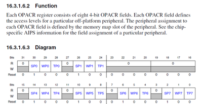

In the first snippet you posted, there is a statement that says "Peripheral access protection is supported by AIPS". Can you please evaluate and confirm if the following register can enable protection to GPIO accesses that you are looking for or you are looking for something different?

We tried, but, as already written, the S32K148 doesn’t allow to configure the access rights of the GPIO controller (the aliased peripheral does not have any registers allowing privilege control).
You can also look at the other snippets posted, taken from file S32K1xx_Memory_Map.xlsx (sheet Peripheral Memory Map).
