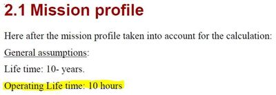

Could you please help to clarify the meaning below?
On page 5 of the ‘S32K116_FIT_Rate_Calculation.pdf‘’ (Functional Safety related document), it mentioned some general assumptions as below. What does Operating Life time: 10 hours mean?

ankur_yadav_07
Hi Sir,
Greetings of the day,
We analyzed your query and this appears to be a typographical error during documentation. This should be the total number of hours in 10 years = 87600 hours. We will update the document to reflect the same soon.
