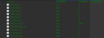

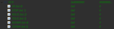

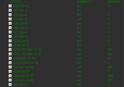

These are the values of the registers just before setting LINCR1[INIT] to 0.
Any idea what could be happening?

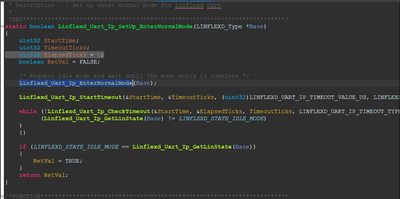

Thanks for contacting us again. I am assuming you are still using the S32E2. I checked how it is done in the RTD and it seems that it is needed to write both SLEEP and INIT bits at the same time:
Are you performing the your configuration in that way?

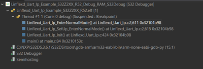

I sopped the program here, just before going to normal mode:
With the following callstack:
