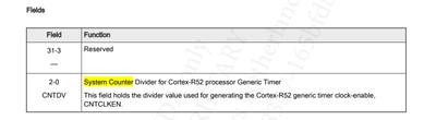

Refer to the Arm® Cortex®-R52 Processor Technical Reference Manual, about the R52, The Cortex-R52 processor does not include the system counter. This resides in the SoC. a set of Generic Timer registers are allocated to the (coproc==0b1111) space.
S32Z have the RTU.GPR to configure the Cortex-R52 processor.
Also, The CNTDV function is System Counter Divider for Cortex-R52 processor Generic Timer.
The STM is System Timer Module, Each RTU subsystem has four STM instances it is different with the system counter。

Discuss this with internal experts, The FXOSC is used as a source clock to a simple SoC counter with a configurable input clock division ratio in RTU.GPR.CFG_CNTDV and the counter output value is connected to Cortex-R52 CNTVALUEB. Typically FXOSC is 40Mhz and after reset CFG_CNTDV is 4. Hence: 40Mhz / 5 = 8 MHz inside Corter-R52 Generic Timer.
In addition, each RTU has its own counter and its divider and there is one Cortex-R52 Generic timer per RTU.
