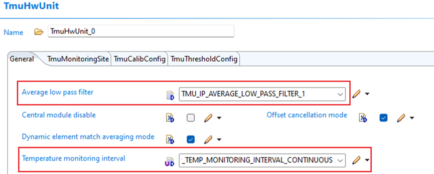

 1. Configure TMU
a. Set the Average Low Pass Filter (ALPF) as 0 to disable the low pass filter for average temperature.
b. Choose Temperature Monitoring Interval (TMI) as the continuous monitoring mode.

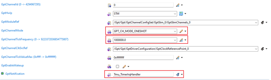

2. Configure timeout timer
a. Enable a timer channel in the GPT module, any of the STM, PIT or Etimer can be used. RTU_STM timer is used in this example.
b. Set the timer to one-shot mode.
c. Set the Tmu_TimerIrqHandler as the notification of the timer.
d. Calculate the channel frequency of the timer being used. The frequency is 1MHz in the example project, which will be used later to calculate the timeout value.

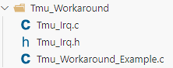

3. Build the workaround code into your project, as a less dependent software package, it is easy to compile. The structure of the workaround software is as below:

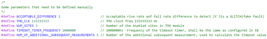

5. Change these parameters according to your own project setup.
