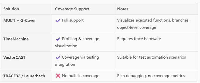

Could you please let me know how code coverage for functions and branches can be achieved on the NXPS32M244 controller using MULTI + G-Cover?
I would like to understand whether this is supported with the GHS compiler and what prerequisites are required for the setup.
Additionally, please share the detailed procedure to enable coverage and generate the coverage report using MULTI and G-Cover.
Thank you in advance.
2,202件の閲覧回数
petervlna
Please see the brief results for your case:
  • Green Hills MULTI IDE + G‑Cover
    • Integrated tool for object-level code coverage (functions, branches, statements) without instrumentation.
  • TimeMachine Profiler
    • Part of MULTI suite; provides execution profiling and coverage visualization using trace data.
  • VectorCAST
    • External testing tool that integrates with GHS for automated unit/integration coverage analysis.
  • TRACE32 (Lauterbach)
    • Advanced debugger; supports GHS symbols but does not provide built-in coverage metrics.
