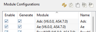

Ae plugin/module from RTD 6.0.0 is generating code to use SPI LSPI0 instead of LSPI1 this is not configurable and its wrong because Ae only can use SPI 1
Version
SPI selection in Ae is not configurable

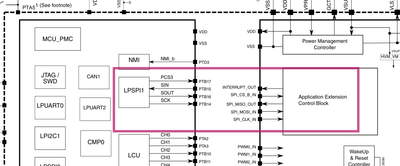

Due to D2D connection SPI 1 need to be used

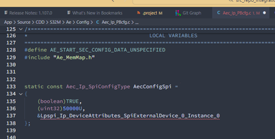

Nevertheless, generated file use SPI 0

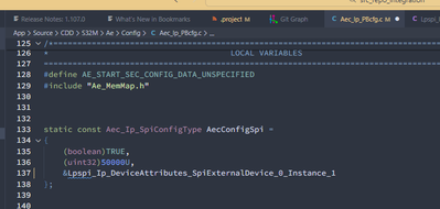

This was modified manually as temporary solution

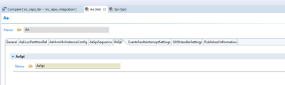

Hi @guillermoarb
Please verify the following:
  1. Open the AeSpiSequence tab in your configuration tool.
  2. Check that the AeSpiSequenceName is assigned to the correct SpiSequence.
  3. Confirm that this SpiSequence has its SpiJobAssignment linked to the appropriate SpiJob.
  4. Verify that the SpiJob has its SpiDeviceAssignment set to the SpiExternalDevice intended for the LPSPI1 instance.
If these instructions seem unclear or confusing, please refer to the example project Ae_Spi_Example_EB_001_S32M276, provided with the RTD, as it can help validate that there is no incorrect or missing configuration.
