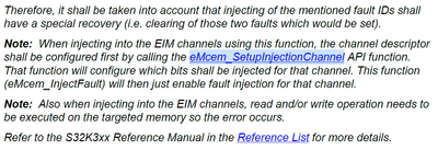

Thank you for the info, i have got clarity on how to select on bits but as per info in the emcem manual after injecting the fault we need to read or write corresponding fault injection related memory area but currently i am not performing that action but still faults are injecting, how it works then?
Below info is is present in section 3.4.2 of S32K3 eMcem(S32K3_SAF_EMCEM_UM) Software Product Rev. 10.0 — 21 January 2025

danielmartynek
Hello @Rudved_3366,
This could be caused by the fact that your stack or application data is located in the memory region where the fault is being injected.
Please analyze the address captured by the ERM and then locate the corresponding address in the .map file. This will help determine whether the injected fault is affecting the stack, a global variable, or another critical memory region used by the application.
