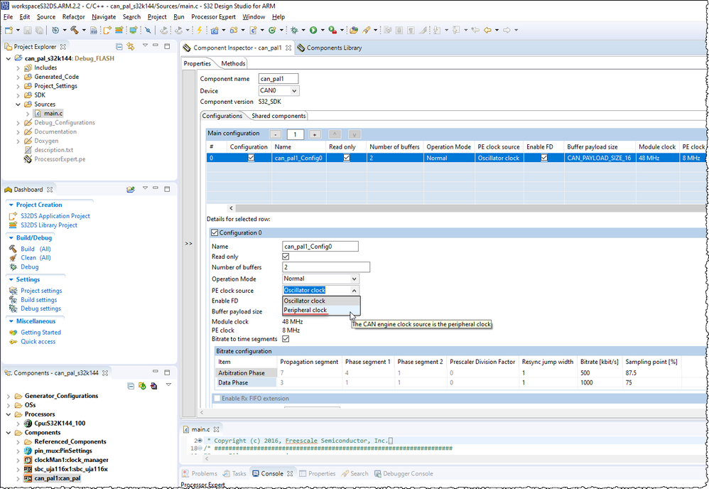

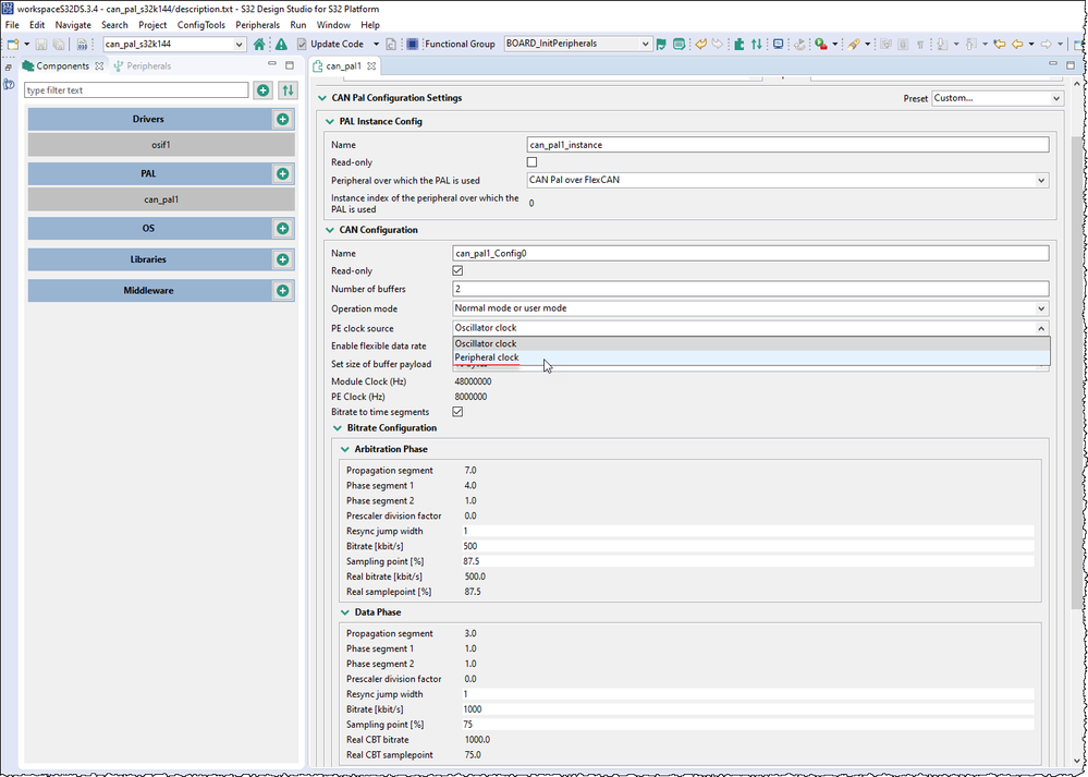

when i use FLEXCAN_CLK_SOURCE_SOSCDIV2 clock source,canfd is normal. Then i exchange the clock source to FLEXCAN_CLK_SOURCE_SYS, Corresponding,i config CBT,and FDCBT by different clock source frequency.which else register should config too ?
1,395 Views
Robin_Shen
Seems that you are using old version SDK. Why not direct select it with Processor Expert or S32 Configuration Tool.
PE clock source Processor Expert.pngPE clock source Processor Expert.pngPE clock source S32 Configuration Tool.pngPE clock source S32 Configuration Tool.png
