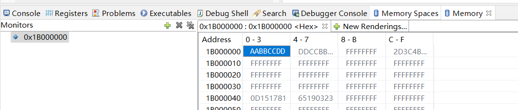

dear NXP expert:
I got a problem after installing HSE firmware.
I installed the HSE firmware by the project provided from FAE and the HSE seems be installed successfully by the information in Access HSE service by MU_B channel_0 - NXP Community
now I download the bootloader code (developed by our side) and the boot can runs only about 9 seconds and it will reset and I check the reset reason and it shows that HSE trigger the reset .if the boot runs in a hardware without HSE firmware installed, it will runs ok.
I download and debug the boot by PE and the S32DS would erase 0x1B000000 by default option.

The HSE SWT RST issue is typically caused by an incorrect clock configuration. For further assistance, please refer to the following post: HSE provides RSP_NOT_SUPPORTED response. It contains valuable information that should help resolve the problem.

hello :
I get the reminder from 触发MCU HSE SWT RST RESET复位 - NXP Community
and I change the clock of HSE , the boot will not trigger reset

I checked the content in 0x1B000000 by PE and it shows it has been written which is not the 0xFF, the content in utest shows the HSE has been activated .
