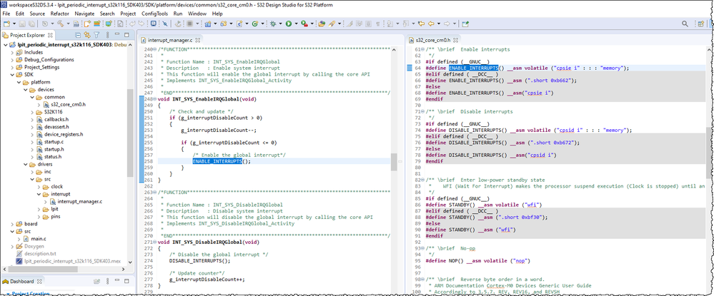

i am getting error when i try to build project.
MCU - s32k144.
Description Resource Path Location Type
make: *** [SDK/platform/drivers/src/interrupt/subdir.mk:20: SDK/platform/drivers/src/interrupt/interrupt_manager.o]
selected processor does not support `cpsid i' in ARM mode C:\Users\AAKASH~1.KUM\AppData\Local\Temp\ccVzPxss.s C/C++ Problem
selected processor does not support `cpsie i' in ARM mode  C:\Users\AAKASH~1.KUM\AppData\Local\Temp\ccVzPxss.s C/C++ Problem

What about using INT_SYS_EnableIRQGlobal and INT_SYS_DisableIRQGlobal?
INT_SYS_EnableIRQGlobal ENABLE_INTERRUPTS INT_SYS_DisableIRQGlobal DISABLE_INTERRUPTS.pngINT_SYS_EnableIRQGlobal ENABLE_INTERRUPTS INT_SYS_DisableIRQGlobal DISABLE_INTERRUPTS.png
