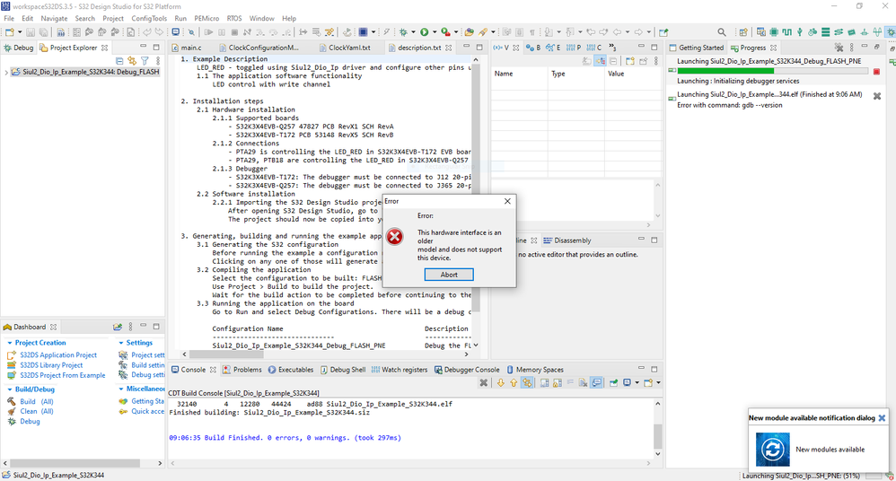

i am not using external debugger its on board debugger only

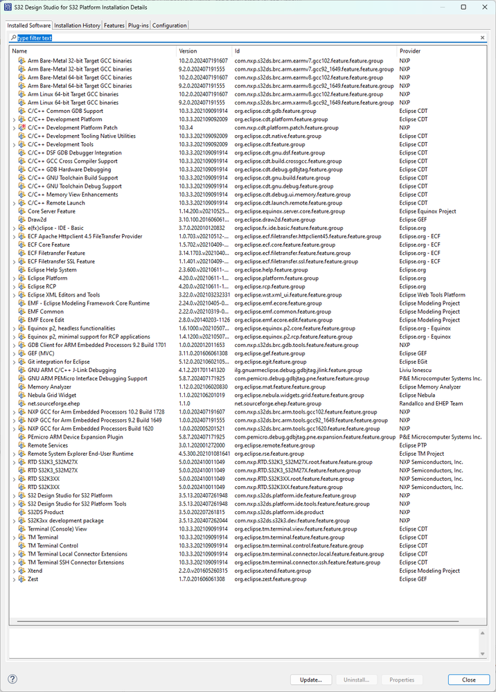

I don't have this problem, please compare my Installation Details

ash123456789
i already have all software installed  still i am getting an error message but for Dio example it works after trying 4 to 5 time but not for pother peripheral

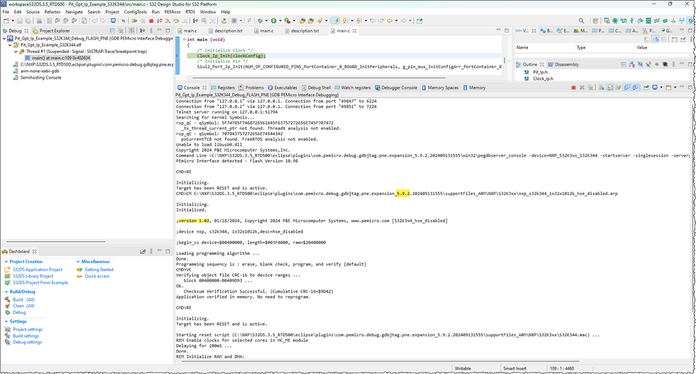

I updated PEMicro software and S32DS Update 14 but still can't reproduce the problem you mentioned. Do you have other development boards? Also, do your colleagues encounter this problem?
In addition, from the ssb.PNG, I can see that the S32K3 RTD you installed is version 3.0.0 P01 instead of the RTD 5.0.0 you mentioned before.

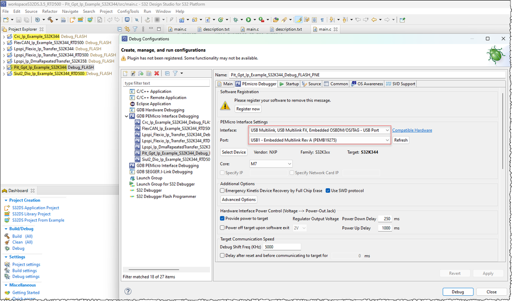

It is recommended to use the onboard OpenSDA (J40) debugger.
Are you using an external PEMicro Multilink debugger? If so, please note:
"USB Multilink FX RevA and Universal Rev A and B are based on legacy UF32 USB devices, which are no longer actively supported/validated by PEmicro under the latest plugins/software packages.
To get latest support user would need Multilink FX Rev C, Multilink Universal Rev C/D or Multilink ACP"
