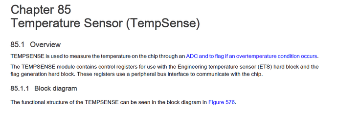

i am using s32k344 evb T172.
and i watched ADC TEMPSENSOR in RM Document.
so does it just read ADC? this ADC TEMPSENSOR is for measuring for MCU Temperature?
this TEMPSENSOR is internal features in MCU?
thanks for help.

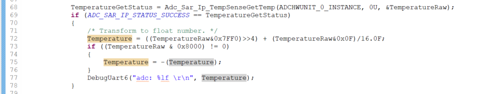

rlaxortn
@Senlent
i wanna to be explain about
what is mean 0x7ff0, 0x0f, 0x8000...?
what is that parameter?
example is same configure with my project configure.
i need to understand i apply formula for getting mcu temperature.
then i can apply to my project.
but i don't under stand that soucecode. because i don't understand why set 0x7ff0, 0x0f, 0x8000.
thanks for help.
タグ(1)
6,439件の閲覧回数
Senlent
Hi@rlaxortn
TemperatureRaw is 16 bits wide, the highest bit is the sign bit (0x8000->0b1000,0000,0000,0000), the lower 4 bits are decimal places (0x0f), and the rest are integer bits.

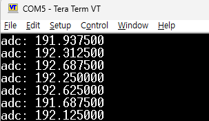

rlaxortn
@Senlent
i build that and i get a temperature data.
but i don't know this is temperature data. because data is so weird.
although this data is Fahrenheit or Degree Celsius, data is so weird.
here is maybe 20 Degree Celsius.
what is wrong i do...?
thank to help.

rlaxortn
@Senlent
/* Transform to float number. */
Temperature = ((TemperatureRaw&0x7FF0)>>4) + (TemperatureRaw&0x0F)/16.0F;
if ((TemperatureRaw & 0x8000) != 0)
Temperature = -(Temperature);
can you explain this source detail?
6,258件の閲覧回数
Senlent
Hi@rlaxortn
I have already answered your question in my previous answer.

@Senlent
i know. so is that data is Fahrenheit or Celsius?
i got that data.
if i set wrong voltage, default vaule is 53.
so what i set value? can i get formula?

Senlent
Hi@rlaxortn
1.i know. so is that data is Fahrenheit or Celsius?
Celsius,

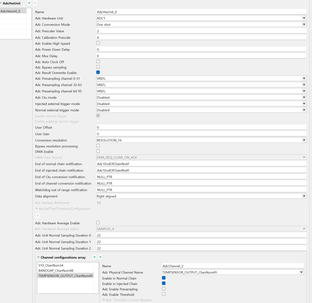

2.if i set wrong voltage, default vaule is 53. so what i set value? can i get formula?
53->0b0011_0101->3.5V
5,906件の閲覧回数
rlaxortn
@Senlent
1. how is set 5V and 5.5V?
thanks to help.
タグ(1)
5,904件の閲覧回数
Senlent
Hi@rlaxortn
5V->0b0101_0000->0x50->80
5.5V->0b0101_0101->0x55->85

5,682件の閲覧回数
Senlent
Hi@rlaxortn
This is my oversight. 5V->0b0101 was mistakenly written as 0b0011
