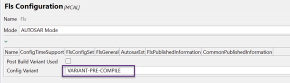

I used S32DS3.5 + RTD2.0 to develop S32K324. Now I wrote the program for the S32K324 based on the configuration and code in the example "Fee_Example_S32K344" and it compiled. but when it ran, the program would report an error as soon as it enters this code" Fls_Init(NULL_PTR);", when I step into it , I found it could not Skip this function " Fls_IPW_Init();". And the err made the program enter this function "
static inline void DevAssert(volatile boolean x)
if(x) { } else { for(;;) {ASM_KEYWORD(BREAKPOINT_INSTR);} }
So I guess if the RTD version doesn't support S32K324 to use the fee function model ? Or could give me some other examples to write Dflash by eeprom mode of S32k324.
Thanks.

Hi @mmyjh_123,
You have two options.
1.
Either change it to VARIANT-PRE-COMPILE
And call it as you do:
Fls_Init(NULL_PTR);
2.
Or select VARIANT-POST-BUILD instead
and call:
Fls_Init(&Fls_Config_BOARD_InitPeripherals);
在原帖中查看解决方案

Hi @mmyjh_123,
1.
Fls_Init(NULL_PTR);
2.
and call:
398 次查看

Oh, I got it,thanks.
