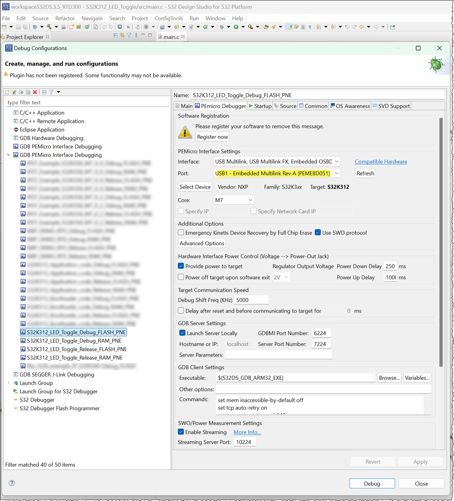

External debugger or onboard debugger did you select?
Follow the steps 3.3 Connect the Debugger Cable,
Connect a micro-USB cable to the J40 connector to debug via the on-board S32K3 debugger.
The D14 should light up. And then you will see the Port: Embedded Multilink Rev A in PEmicro Debugger configuration view:
3,284件の閲覧回数
LEEYM
I USE ON BOARD THE BUG NAME :  Debugger : U-Multilink
AND, WHEN I CONNECTED BY, POWER, USB, AND J12 DUBUGGER PINS
TURN ON TRTPWR IN MY DEBUGGER...
And when I did it for the first time, it was debugging
I can't do it all of a sudden
I changed it to GDBMI FORT NUMBER and SERVER FORT NUMBER
But now it's the same environment you sent me
3,270件の閲覧回数
Robin_Shen
Please note that some older versions of Multilink do not support S32K3, see the discussion in: s32ds-v3.4 debug s32k344 via PE
Tell me the version of S32K3 RTD you use.
Or send me the project you tested for checking.
Have you tried the onboard debugger (J40) with J12 disconnected?
