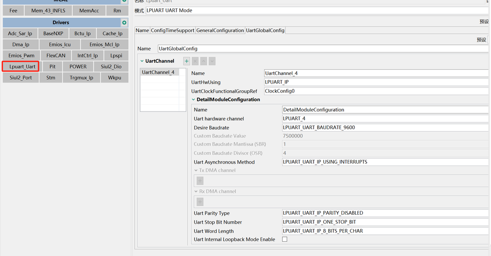

fengba_360
Where is this 1-byte buffer configured? Is it in this function: Lpuart_Uart_Ip_AsyncReceive(UART_LPUART_INTERNAL_CHANNEL, buffer, 1U)? For example, if I configure it as 2 bytes here, will receiving 2 bytes trigger the callback due to the PUART_UART_IP_EVENT_RX_FULL event? Or does it involve the FIFO exceeding 4 bytes? I'm a bit confused about this.
6,085 Views
Julián_AragónM
Hi @fengba_360.,
You are correct, it is configured inside the AsyncReceive function with the 1U parameter.
Yes. You can see in the project I've shared, when configured for 1 byte, the callback is entered with event RX_FULL when 1 byte is received.
Julián
6,006 Views

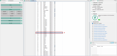

fengba_360
When I debugged, the system enters a HardFault error upon executing this specific line of code.
/* Clear the error/interrupt flags */
Base->STAT = LPUART_FEATURE_STAT_REG_FLAGS_MASK;
5,953 Views
Julián_AragónM
Hi @fengba_360,
I can see you have the POWER module included in your project. Do you have the LPUART4 peripheral clock enabled for the mode you are using?
Julián
5,899 Views
fengba_360
You're absolutely right—it's indeed not enabled here. My apologies, I’ve been tied up with the project over the past few days and didn’t reply in a timely manner.
5,875 Views
Julián_AragónM
Hi @fengba_360,
No worries! I'm glad the issue was resolved.
Julián
6,008 Views

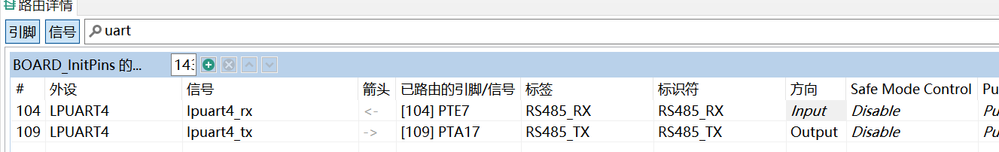

fengba_360
When I initialize using the following code, the MCU enters a HardFault. Could this be caused by an incorrect initialization method?
void lpuart_Init(void)
Lpuart_Uart_Ip_Init(UART_LPUART_INTERNAL_CHANNEL_4, &Lpuart_Uart_Ip_xHwConfigPB_4);
IntCtrl_Ip_EnableIrq(LPUART4_IRQn);
IntCtrl_Ip_InstallHandler(LPUART4_IRQn, LPUART_UART_IP_4_IRQHandler, NULL_PTR);
Lpuart_Uart_Ip_AsyncReceive(UART_LPUART_INTERNAL_CHANNEL_4, (uint8_t*)rx_data_uart, 1u);
