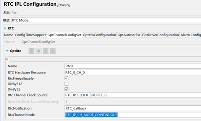

I use Rtc and Wkpu components in my project. I want to wakeup mcu from standby by Rtc. But Rtc not working.I cannot upload my code due to company restrictions.
I reference S32K344_Standby_RTC_Wakeup_Example_090_34 code, but Rtc not working.
So,I need an example program which wake up from low power consumption through RTC based on S32K312。
Please help me,thanks.

sunxujiang
sunxujiang_1-1661498738684.pngsunxujiang_1-1661498738684.pngsunxujiang_2-1661498765969.pngsunxujiang_2-1661498765969.png
Is there any problem in configuration?
