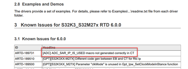

Hi.
Currently ADC_SAR_IP_IS_USED is STD_OFF, so I have a problem that the Adc_Sar_Ip_Init function is disabled. I've tried several settings in Design Studio, but I'm not finding a way to change DC_SAR_IP_IS_USED to STD_ON. Can you help?
line 139 at Adc_Sar_Ip_CfgDefine.h
#define ADC_SAR_IP_IS_USED (STD_OFF)

Hi@Hoon
Sure, please tell us more info, such as RTD and IDE version, the MCU part number, or you can share your demo project.

Hoon
Hi @Senlent
MCU P/N : S32K312NHT0MPASR
IDE : Design Studio 3.6.2
RTD : like as below
* Autosar Version : 4.7.0
* Autosar Revision : ASR_REL_4_7_REV_0000
* Autosar Conf.Variant :
* SW Version : 6.0.0
* Build Version : S32K3_RTD_6_0_0_CD02_D2505_ASR_REL_4_7_REV_0000_20250509
please let me know if you need additional information

Senlent
Hi@Hoon
This should be a know bug.
You can modify it manually or upgrade to S32K3_S32M27x Real-Time Drivers ASR R21-11 Version 6.0.0, where the macro definition is enabled by default.

Hoon
Hi @Senlent
I already use RTD, S32K3_S32M27x Real-Time Drivers ASR R21-11 Version 6.0.0 CD02
Is this different from what you said?

Senlent
Hi@Hoon
yes, i have attached it for your reference.
