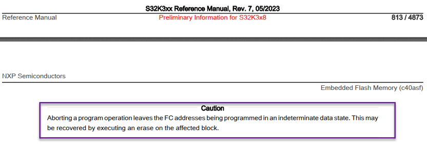

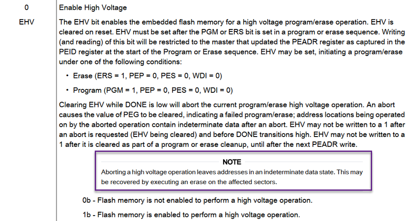

danielmartynek
Hi @luyq,
Unfortunately, aborting the operation leaves the flash in an indeterminate state.
