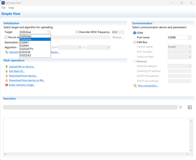

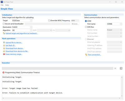

hi  ,
   ECU S32k358 ,I want download bootloader bin to flash,s32k358 flash programmer open failed,
open flash tool.exe ,cannot find s32k target
any help ? Thanks!

Hi@jimmy623
Sorry, the flash programmer didn't support S32K3.
you can use j-flash or PE other debugger tools.
