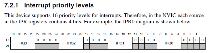

How many bits out of 8 are used in s32k148 for ISR priority configuration?

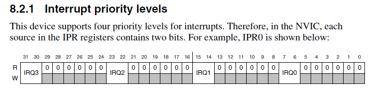

Hello Jakub,
Please see below (S32K1xx RM rev.12.1).
Only the 4 MSB on S32K14x (CM4) and 2 MSB on S32K11x (CM0+).
