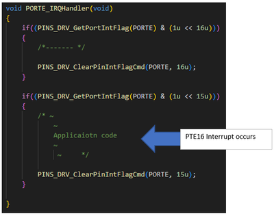

hello. I ask the question as follows.
During PORTE_IRQHandler operation by PTE15 interrupt,
How is it handled when a PTE16 interrupt occurs?
After completing the PORTE_IRQHandler operation, is the PORTE_IRQHandler function called again?
Otherwise, it is expected that missing or duplicate processing will occur.
-> If there is no re-call, it is thought that PTE16 interrupt processing will be missed.
-> If PORTE_IRQHandler is called again when a PTE16 interrupt occurs, it is thought that problems will occur due to duplicate processing of code.

yes, it will call PORTE_IRQHandler again.

I think it would be correct to put the INT_SYS_DisableIRQGlobal / INT_SYS_EnableIRQGlobal functions at the top and bottom of the PORTE_IRQHandler function, respectively, to pending other interrupts during IRQ processing, and to handle the pending interrupt after IRQ processing is completed.
tell me your opinions.

I don't think it is necessary since the process sequence is still the same.
if you have in doubt this, you can make some test for your options.

Does this mean there is no "Pre-emption" because the group priority is the same?

for all pins of PORTx share one Vector Address, so these is no difference in priority
