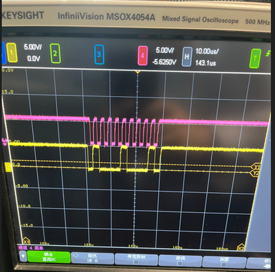

i find the waveform like below,  it only send the addr 0x44

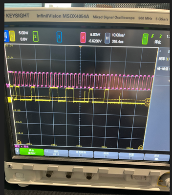

but if send like this, you can see addr 0x44, 0xcc, 0x44 be send and also other data be send
uint8_t cmd[2]={(uint8_t)(CONVERT_T >>8), (uint8_t)(CONVERT_T & 0xFF)};
uint8_t ret = LPI2C_DRV_MasterSendDataBlocking(INST_LPI2C0, cmd, 3, true, OSIF_WAIT_FOREVER);
        printf("ret=%d\n\r",ret);
can you help to check , what is happend with i2c driver ?

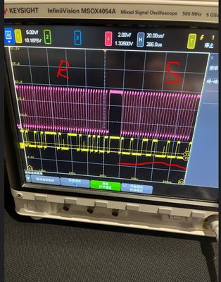

when i remove OSIF_TimeDelay(20); or printf
uint8_t ret = LPI2C_DRV_MasterSendDataBlocking(INST_LPI2C0, cmd, 2, true, OSIF_WAIT_FOREVER);
//printf("ret=%d\n\r",ret);
//OSIF_TimeDelay(20);
uint8_t data[3];
ret = LPI2C_DRV_MasterReceiveDataBlocking(INST_LPI2C0, data, 3, true,OSIF_WAIT_FOREVER);
then waveform become below, it seems the send data is ok, why delay, or printf will influence i2c communicate ?

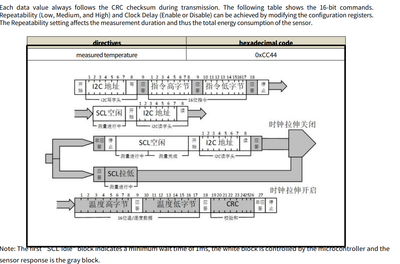

there is no special after send for slave device, look at the spec when send complete, it should wait for the measurement, then read.
SCL空闲 ---> SCL IDLE
I2C 地址 ——> I2C address
指令高字节 ---> command MSB
指令低字节 ---> command LSB
the wired thing is when add the delay after receive, it still same wrong waveform as before.

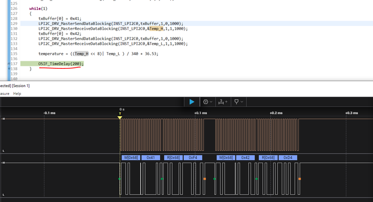

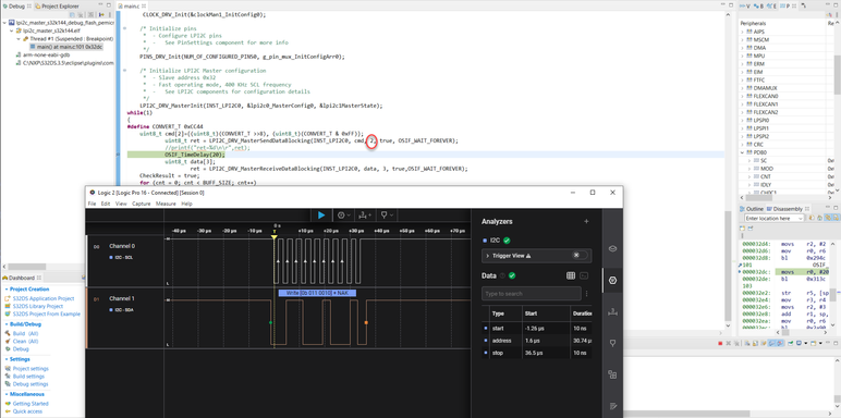

I don't have the sensor you used and tested, so I can't help you reproduce the problem.
But I am sure that this is related to the sensor.
For example, I tested a sensor and added "OSIF_TimeDelay" to it as you said.
I tested it in two ways and both met my expectations.
Test 1.
Test 2.
You can see there is no probem on myside.
