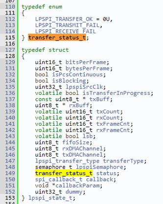

Hi@buccno
  User can judge whether an error occurs during the transmission process according to the returen value of the API.
For your reference.

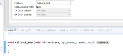

buccno
I got it I could use this return value for lpspi, but for the flexio spi, how can I write the callback function and functions parameter?
In s32DS
I cannot change it because its type is const. (I think that's why you made an error)
