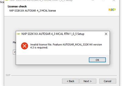

huhu111
When I install the MCAL section of EB Tresos for S32K14X, it always pops up with the error message "Invalid license file.Feature AUTOSAR_MCAL_S32K14X version 4.2 is required". I guarantee that my MCAL and License are the same.

Furthermore,
If I put wrong license file I see:
If I put correct license just generated from our web page:
I can continue with the installation.
So obviously your license file is not correct. Please try to return license and generate it again.
Peter

petervlna
As you can see MCAL for S321K is legacy SW and is replaced with RTDs:
Please use the RTDs instead where are examples for EB tresos available.
