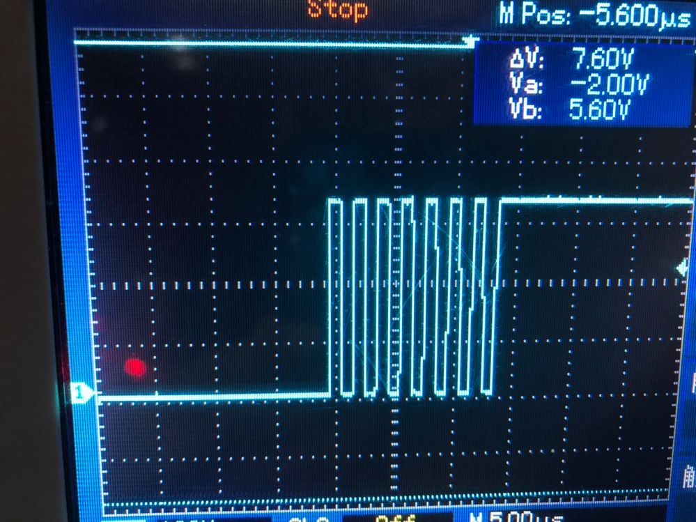

I want to send a message, but the oscilloscope can only see CS pull low and CLK waveform, SIN and SOUT have no waveform.

Thanks, the problem has been solved, I disable the PCS function, the way the CS pin passes GPIO。But I don't know if I have a problem with this operation.

   Do you know how to configure SPI corresponding registers before you use SPI.
You need to check the manual how to configure the register bits exactly.
   BTW, use your multimeter to check the power circuit part and other important circuit parts to check if the oscillator works normally or not.
Thomson

Hi Lei,
I tried to take a look over your project but is hard to check it because you mix register write, public API and hardware abstraction layer which shouldn't be used by application layer.
I think the problem is on your pins configuration. I don't see where pins direction is configured in OL_SDK_LPSPI_Init, there is configured just mux for your signals.
Razvan
