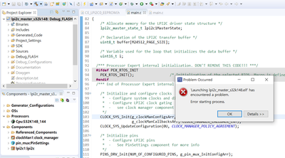

I am a developer developing with S32K148.
I ended up using the S32K148 on a new project.
I have installed S32 Design Studio for ARM Version 2.2.
And, I tried to run the S32K148_Project_Hello sample code.
However, an error message occurred as shown in the picture below.
I think the part I set is wrong.
But I don't know what the problem is.
I set it up as pictured below.
Please point out the problem to me.
thanks,

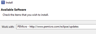

If you use PE Micro Multilink, you need to use the GDB PEMicro interface.
Please go to Help / Install New Software
Select PE Micro Update side and install the interface

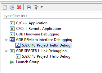

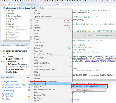

First, right-click the project and run it as Debug As->S32DS C/C++ Application.
An error has occurred.

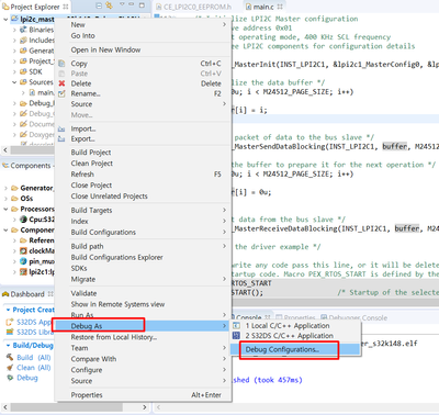

Second, I run Debug As->Debug Configurations..
And add Executable: ${cross_prefix}gdb${cross_suffix} and run
It runs fine.
After that, if I try the first method(right-click the project and run it as Debug As->S32DS C/C++ Application.), the same error occurs.
I'm repeating this behavior every time I run it.
It's too inconvenient.
If you additionally run As, an error occurs as shown in the picture below.
Please tell me how to run it as Debug As->S32DS C/C++ Application.

danielmartynek
Hello @s_kim1,
The S32DS C/C++ Application is not for the S32K MCUs, it is for .exe x86 application apparently.
Please use GDP PE Micro / GDP SEGGER for S32K1xx.
