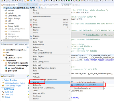

I completed the installation, but the problem still occurs.
Please see the picture below.
First, right-click the project and run it as Debug As->S32DS C/C++ Application.
An error has occurred.

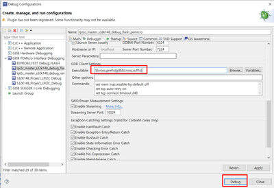

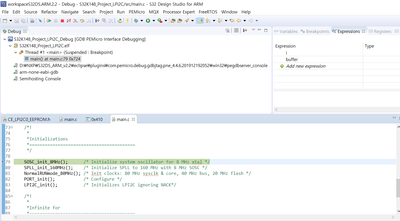

Second, I run Debug As->Debug Configurations..
And add Executable: ${cross_prefix}gdb${cross_suffix} and run
It runs fine.

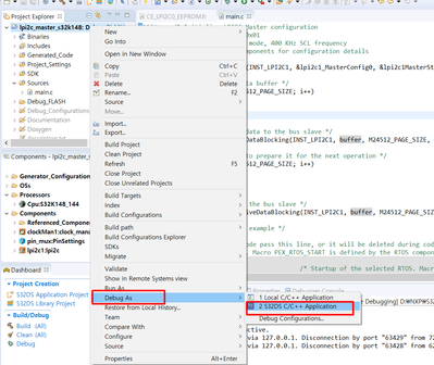

After that, if I try the first method(right-click the project and run it as Debug As->S32DS C/C++ Application.), the same error occurs.
I'm repeating this behavior every time I run it.
It's too inconvenient.

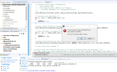

If you additionally run As, an error occurs as shown in the picture below.
Please tell me how to run it as Debug As->S32DS C/C++ Application.

danielmartynek
Hello @s_kim1,
The S32DS C/C++ Application is not for the S32K MCUs, it is for .exe x86 application apparently.
Please use GDP PE Micro / GDP SEGGER for S32K1xx.
