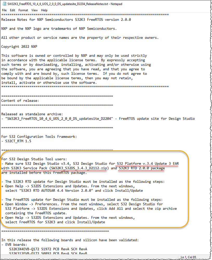

s32 design studio version 3.4 installing RTOS package like that issue came how can i resolve this issue. Below mentioned that issue Operation details Software being installed: com.nxp.FreeRTOS.S32K3.root.2.0.0.feature.feature.group 2.0.0.202204280242 Missing requirement: com.nxp.FreeRTOS.S32K3.root.2.0.0.feature.feature.group 2.0.0.202204280242 requires 'org.eclipse.equinox.p2.iu; com.nxp.RTD.S32K3XX.root.2.0.0.feature.feature.group 0.0.0' but it could not be found

Did you follow the steps descripted in SW32K3_FreeRTOS_10_4_6_UOS_2_0_0_DS_updatesite_D2204_ReleaseNotes.txt?
SW32K3_FreeRTOS_10_4_6_UOS_2_0_0_DS_updatesite_D2204_ReleaseNotes.pngSW32K3_FreeRTOS_10_4_6_UOS_2_0_0_DS_updatesite_D2204_ReleaseNotes.pngMake sure S32 Design Studio v3.4, S32 Design Studio for S32 Platform v.3.4 Update 3 EAR with S32K3 Service Pack (SW32K3_S32DS_3.4.3_D2112.zip) and S32K3 RTD 2.0.0 package are installed before this FreeRTOS package.
