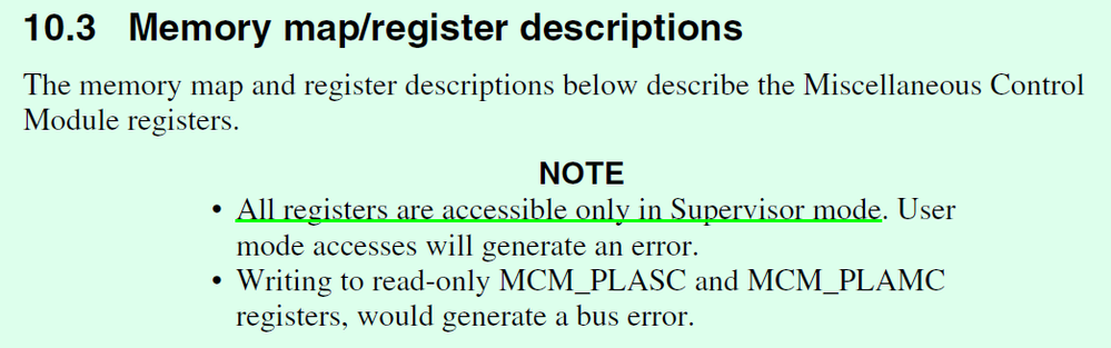

I want to use PID to define different access rights for different user tasks. It seems that I should dynamicly change the MCM_PID reigster.
Referring to the RM for S32K1xx, it says the MCM_PID is accessible only in Supervisor mode. While the user tasks are running at user mode. How can I change the MCM_PID in user tasks?

Could you clarify where it is stated that MCM_PID can be accesses only in supervisor mode? In my opinion it is accessed in both modes.

Hi David,
Thanks.
It lies in Section 10.3 of S32K1xx Series Reference Manual, Rev. 12.1, 02/2020.

I have been confirmed that if application is in user mode, it can not change MCM_PID. Usually, the value of MCM_PID should be defined in supervisor mode.

So will there be a way to define different values of MCM_PID for user application? Like a lib function that could change to supervisor mode and modify the MCM_PID, then return to user mode?
