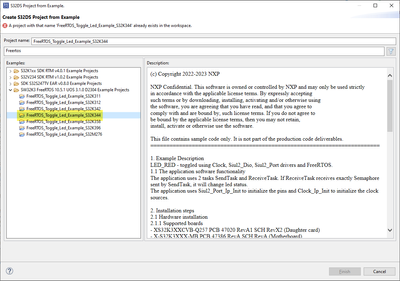

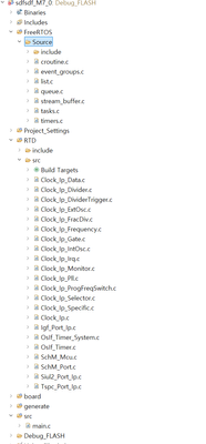

We are working on an automotive security project and purchased NXP's S32K324 board to use HSE. Currently, we've installed S32 Design Studio and uploaded FreeRTOS, as shown in the image. However, when we connect the board to the desktop, nothing happens, and we can't build or debug anything.
Do we need to install something else, or do we need to purchase a debugger? We’re not quite sure about the overall setup.

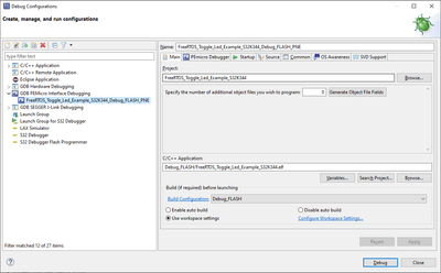

No, no additional equipment is needed other than connecting the 12 V power supply adapter and switch SW1 to the ON position (fully to the left), and to connect a micro-USB cable to the J40 connector to debug via the on-board S32K3 debugger.
You do need to setup the drivers and FreeRTOS package for S32DS. Since you are already using the FreeRTOS components, I assume you have already followed the installation flow for the package. For example, here are the release notes for FreeRTOS S32K3 5.0.0:
If you have the FreeRTOS package installed, you can import the FreeRTOS_Toggle_Led_Example_S32K344:
After building the project, you can simply debug with the PEMicro Interface Debugging configuration if you are using the USB (OpenSDA) connection from the S32K3X4 EVB:
