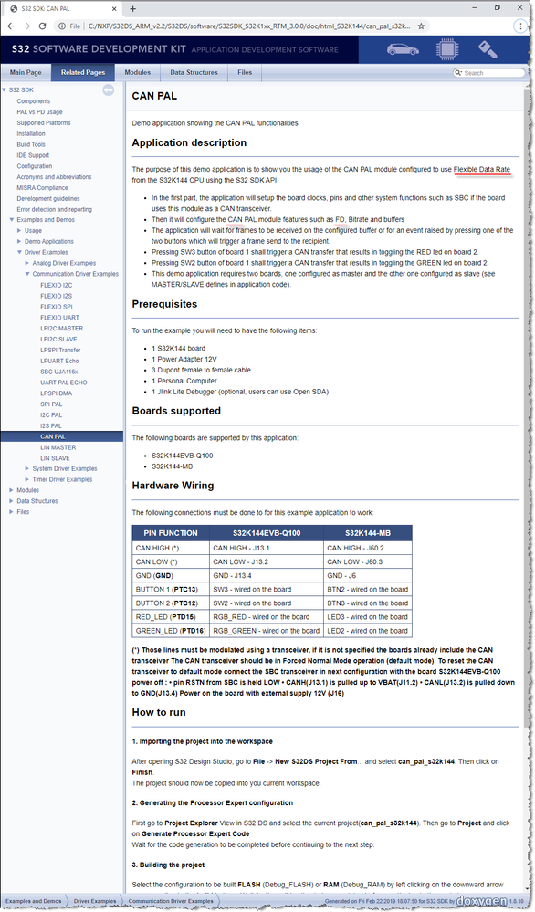

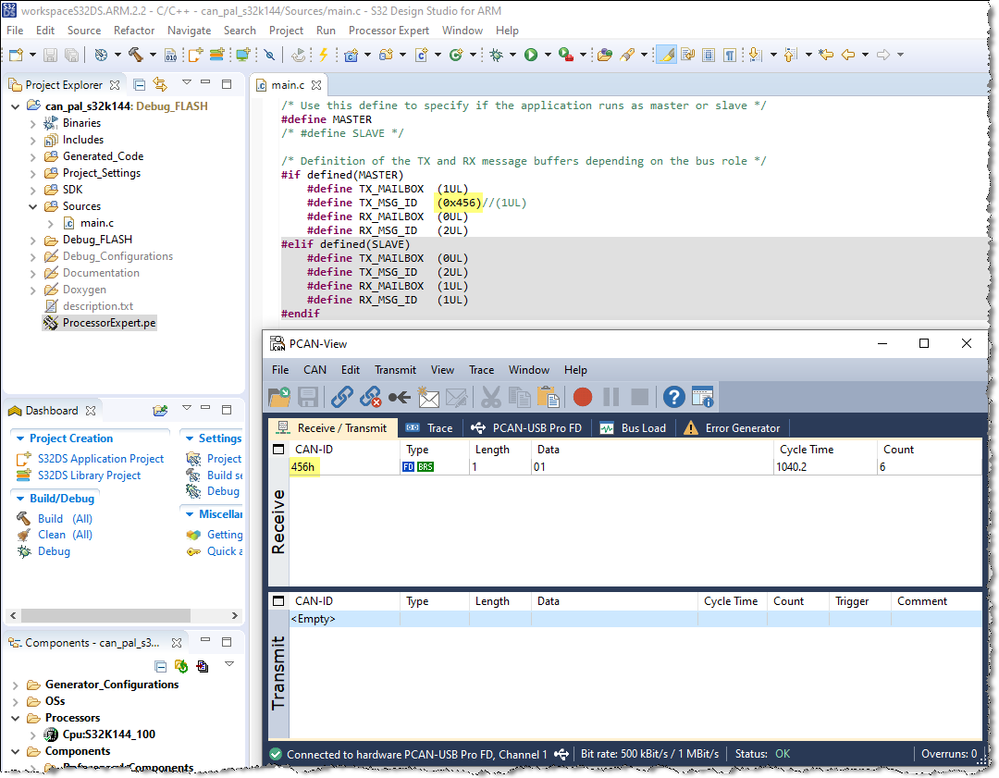

Robin_Shen
Hi  Pierpaolo Dini ,
If you modify the #define TX_MSG_ID (0x456) in can_pal example.
Does the S32K144EVB able to transfer CAN message on CAN bus.(PCAN View can be used to observe the CAN bus)
Please first make sure it works.

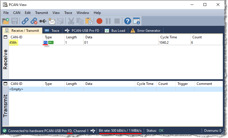

Robin_Shen

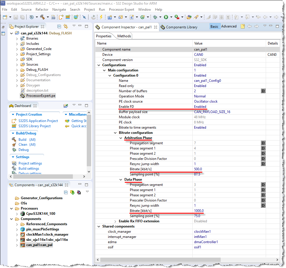

I am not sure your Arduino and CAN analyzer configured the same protocol as NXP CAN PAL example.
Here you can check the CAN FD protocol configuration:
