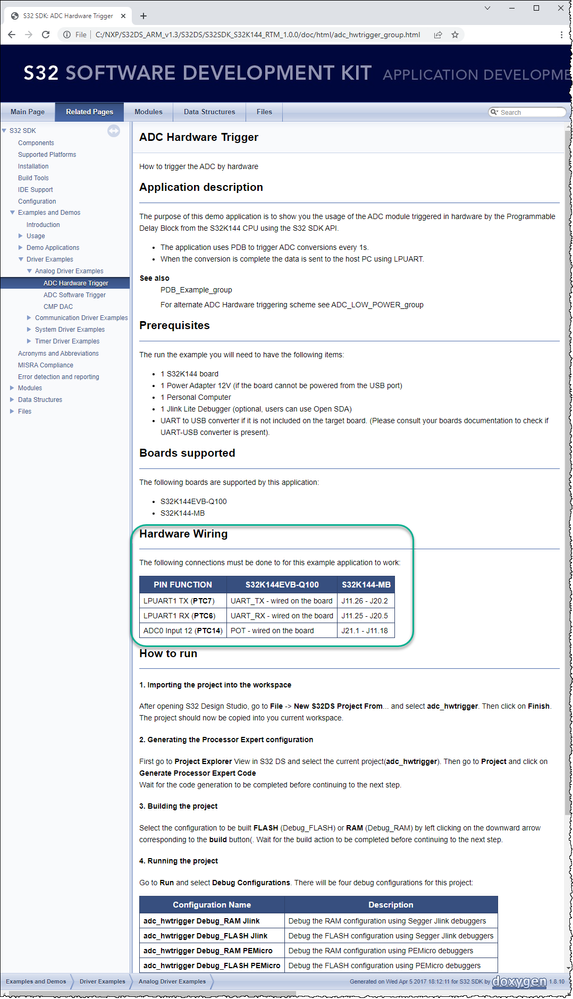

Robin_Shen
Hi akhilranga,
Please refer to adc_hwtrigger_s32k144 in S32SDK S32K1xx RTM:

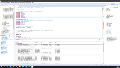

akhilranga
Hi @Robin_Shen
thanks for the advice about the version 1.3
I tried the adc_hwtrigger, but got lots of errors. can you please help me resolve it. Attaching the screen shot down below.
 Thank You

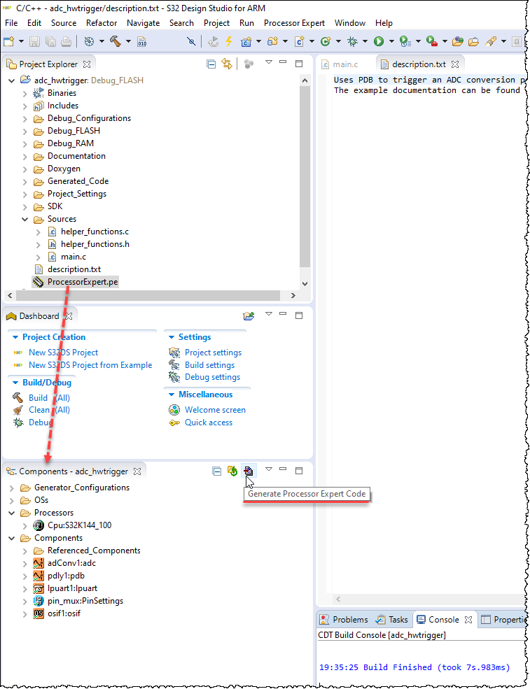

Robin_Shen
Please click "Generate Processor Expert Code" and then Build the project.

Robin_Shen
The example documentation can be found in the S32 SDK documentation at Examples and Demos section. (<SDK_PATH>/doc/Start_Here.html) Please read the manual of ADC Hardware Trigger
