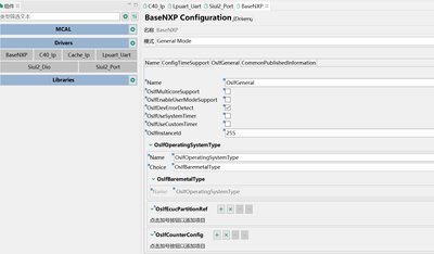

I can find platform.driver.osif in the components selection, but there's no osif_time_delay function in the generated osif.h.
only below function definitions are found:
OsIf_Init(const void* Config)
OsIf_GetCounter(OsIf_CounterType SelectedCounter)
OsIf_GetElapsed(uint32 * const CurrentRef, OsIf_CounterType SelectedCounter)
OsIf_SetTimerFrequency(uint32 Freq, OsIf_CounterType SelectedCounter)
OsIf_MicrosToTicks(uint32 Micros, OsIf_CounterType SelectedCounter)
Is there any way to get osif_time_delay get ready to use?

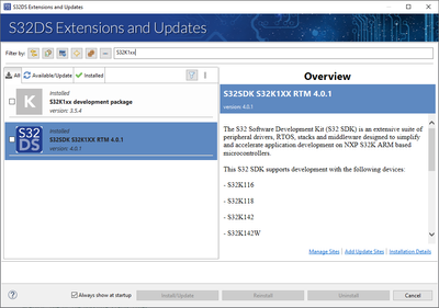

Hi @towenyu,
You can install the package through S32DS by going to "Help > S32DS Extensions and Updates" and searching for the S32SDK S32K1XX RTM 4.0.1 package:
I hope you find this helpful!

Julián_AragónM
Hi @towenyu,
Unfortunately the RTM package is not available for the S32K3 family. I would recommend using it as a base and porting the function into your project, as there is no function in the RTD's (S32K3 package). I apologize for any inconveniences this may cause.
Julián.
