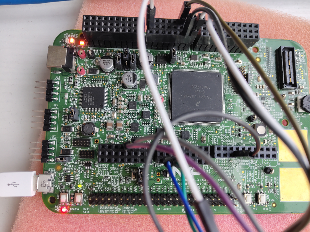

hello:
s32k148evb board;

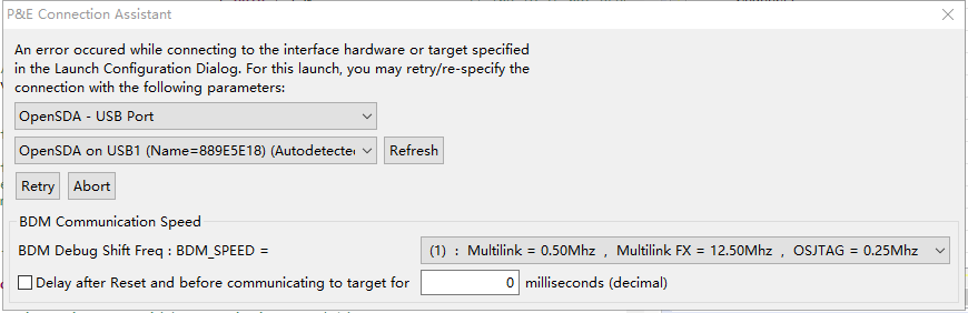

I used s32ds to flash an .elf file to the board yesterday, it shows some secure information but I didn't care, and now I can't debug or flash with s32ds again. it reminder some information behind:
The board sda LED is light red when connect to pc through usb, like this:
Can I have anyway to solve this problem? thanks!

Hello Xia,
I would like to ask you do you have any other debugger than OpenSDA, for example, J-link, Lauterbach,...?
Diana
