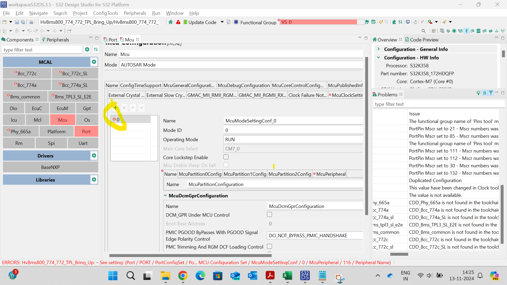

Im trying to run the HV BMS bring up example  and facing below issues in execution.
1. SDK is added but still shows the file not found in toolchain.
2. Errors showing for 1.  Name under McuModeSettingConf.
      2. McuClockSettingConf
3. Error with Port Mscr. I have tried renaming pin tools but issues still remained.
Please help in resolving these issues asap.
Error screenshots attached.
(Info: RTD R21-11 5.0.0,  BMS_GEN1_SDK_4.4_R21-11_1.0.3,    S32DS 3.5,  S32K358, AUTOSAR is used)

Hi @PADMA
HVBMS-RD Bring-up Example version 1.0.3 for S32K358 devices and S32K3 BMS GEN1 SDK 4.4 and R21-11 Version 1.0.3 were developed and tested using S32K3 Real Time Drivers AUTOSAR 4.4 and R21-11 Version 3.0.0, so its functionality is not guaranteed with other RTD versions.
Please use the software packages that the HVBMS-RD Bring-up Example depends on. You can find this information in the release notes.
BR, VaneB
