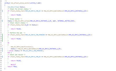

meminfls_mainfunction causes the hardfault

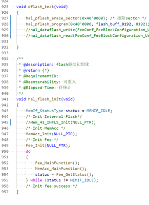

as the function described below,when uses the iar to download and debug,it will cause hardfault;but if i try tu debug with hal_dataflash_write,everything works well.
can any one give me some advices?

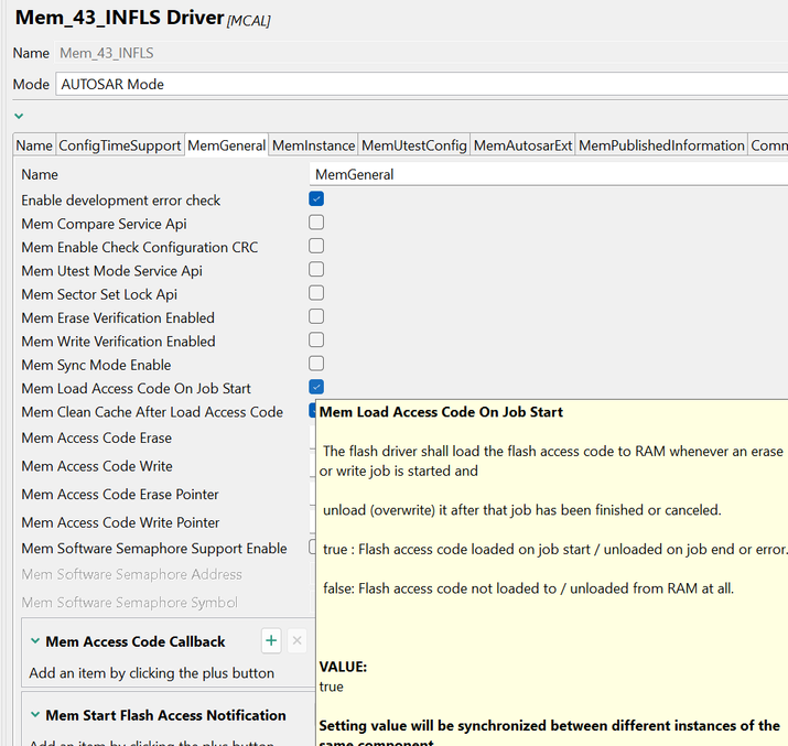

Hard to say just from the description, but the driver must not be in the programmed flash block.
I see you program block_0 at 0x400000 where the application typically is.
The Mem_43_INFSL driver can use SRAM (below S32DS IDE configurator).

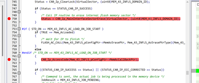

Because the address i try to erase and prohran in at the bank of the functiob, the 0x400000 - 0x500000 is the one bank, but even i put the code in the ram ,it caused the hardfault too,however ,if i erase at the 0x500000,the function runs well.
So why even the code runs in sram,it will cause hardfault when tried to program at 0x400000?
