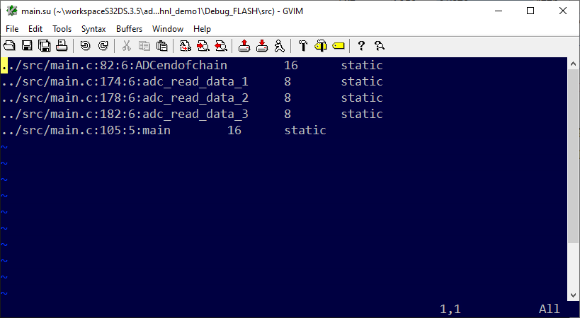

I'm not sure what's your compiler - for gcc you can use -fstack-usage option to get used stack for each function. During compilation is for each object file (*.o) generated *.su file with stack usage:
You can add -fstack-usage in project properties:
You can find more details here - https://mcuoneclipse.com/2015/08/21/gnu-static-stack-usage-analysis/
