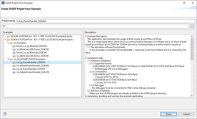

i am building project with S32k312 and lpuart_lin,could you please give me a example about it ,S32K3,thank you

there is demo example within RTD, you can refer to it

what i need is non-autosar and lpuart_lin,not flexio or autosar driver ,thank you

Lin_ip_frameTransfer example shows usage of low level RTD drivers for both LPUART and FlexIO modules. There is also SDK driver examples, if needed.
If you need some baremetal code you can reuse below one, LPUART is the same.

i had finished my project three months ago with S32K144 lpuart_lin,what i need is S32K3X,the s32k1x is different with s32k3X,thank you

I am not aware of S32K3 lpuart lin baremetal example, just RTD based one is available as I mentioned above.
