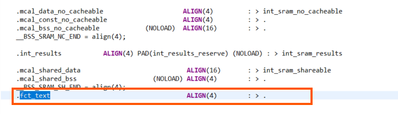

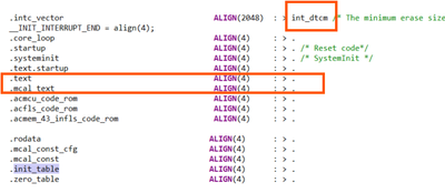

dear NXP experts:
I have a question about ram code:
I want to download a "fct.hex" into RAM and jump into the "Fct.hex" to run the dedicated function.
because there is pure free memory only in DTCM and last 32K "int_sram_shareable " in bootloader. so I think the FCT.hex can only be placed in the two areas.
so I modify the link file as attached. and the final hex is show as picture below.
after I debug the hex by PE it failed in the function that located in the second block.
if I do not split the hex into two blocks and it works OK if the whole hex is located in DTCM.
I  also try to take use of ".ROM.fct_text ROM(.fct_text)" and add a copy table in "init_table" which is in startup_cm7.s but it still failed.
could you pls help me and thank you very much.

yin_qiu
hello :
thank you for reply and I find the root cause that the "__INT_SRAM_END" is set to ram_rsvd2.so once the SW runs ,the contents located in "int_sram_shareable" will be erased by startup code.
I modify the "linker_flash_s32K312.ld " to make it work as "inker_sram_s32K312.ld" do. so the code runs in sram without copying from pflash to sram.
