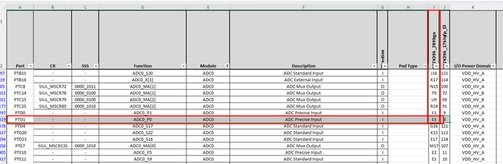

currently I'm Working On S32K396BMS-EVB board i have to work on ADC but I don't get proper pin configurations related to this board how i can do please help me on this issue . I'm referring S32K396BGA board for ADC but there is diff pin numbers so I'm confused here .

Pin assignment is decried in reference manual attachment : IO_mux table excel sheet.
For example ADC0_P0 channel for BGA package is port PTD1.

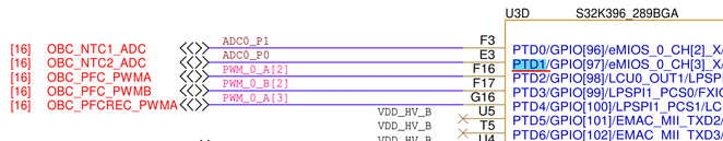

Check the schematic of the EVB to see on which pin is PTD1 connected on the board. It is on E3.
https://www.nxp.com/webapp/Download?colCode=S32K396BMS-EVB-DESIGN-FILES
For the SW configuration you can follow SW examples integrated on RTDs in design studio or EB tresos.
